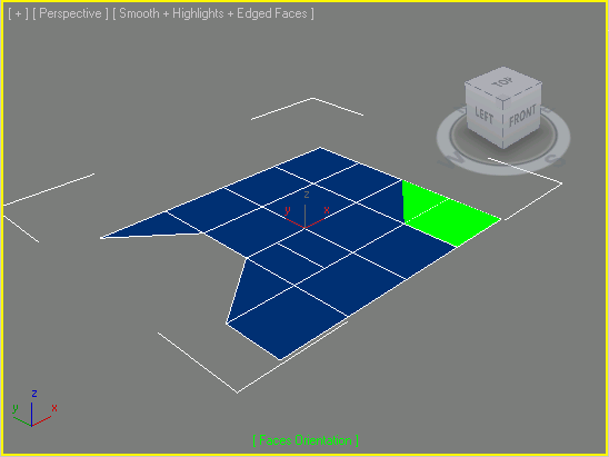

The FaceOrientation Core Interface exposes methods for interacting with the Face Orientation xView Checker.

Since the purpose of the Face Orientation check is to simply shade the backsides of all faces in the highlight color, it always returns an array of ALL faces into the results array.
