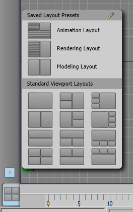

View Panel Preset Management
<integer>ViewPanelManager.GetPresetCount()
Returns the number of available named View Panel presets.

<index>ViewPanelManager.GetPresetID <string>presetName
Returns the ID of the named View Panel Preset.
<bool>ViewPanelManager.DoesViewPanelPresetExist <string>presetName
Returns True if a View Panel Preset with the name specified by the argument exists.
Returns False if the View Panel Preset with the specified name does not exist.
<integer>ViewPanelManager.GetViewPanelPresetLayout <integer>presetIndex
Returns the layout of the indexed View Panel Preset as an integer, or -1 if the specified presetIndex does not exist..
<index>ViewPanelManager.CreateViewPanelFromPreset <string>presetName <bool>isActive
Creates a new View Panel from the specified named preset.
If the second argument is set to True, the View Panel will also be made active.
Returns the index of the new View Panel.
<bool>ViewPanelManager.CreatePresetFromActiveViewPanel <string>presetName
Creates a new Preset with the specified name from the active View Panel.
If the name already exists, it will be appended a numeric suffix, e.g. "Test" will become "Test 01".
Returns True on success, False on failure.
