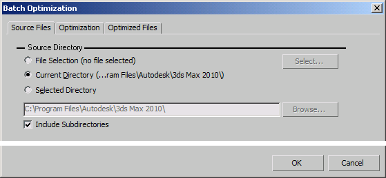

Source Files Tab
Source Directory Section
BatchProOptimizer.SourceFileMode : integer : Read|Write
Get/set the internal value equivalent to the index of the "Source Directory" radio buttons selection.
Possible values are:
0 - File Selection - uses the files array specified via the BatchProOptimizer.SourceFileFiles property.
1 - Current Durectory
2 - Selected Directory
BatchProOptimizer.SourceFileFiles : filename by value array : Read|Write
Get/set the array of source files to process when the . SourceFileMode property is set to 0. Default is #().
BatchProOptimizer.SourceFileDir : string : Read|Write
Get/set the source directory to process when the . SourceFileMode property is set to 2. Default is ""
BatchProOptimizer.SourceFileSubDir : bool : Read|Write
Get/set the state of the internal option equivalent to the "Include Subdirectories" checkbox.

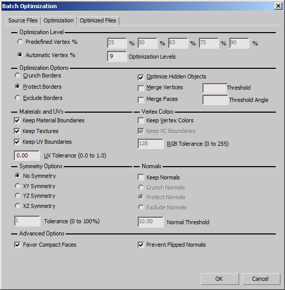

Optimization Tab
Optimization Level Section
BatchProOptimizer.OptimizationLevelMode : integer : Read|Write
Get/set the internal value equivalent to the Optimization Level Mode radio buttons selection.
0 - Predefined Vertex %
1 - Automatic Vertex % (default)
BatchProOptimizer.OptimizationLevel1 : integer : Read|Write
Get/set the value equivalent to the first optimization level value. Default value is 25.
BatchProOptimizer.OptimizationLevel2 : integer : Read|Write
Get/set the value equivalent to the second optimization level value. Default value is 50.
BatchProOptimizer.OptimizationLevel3 : integer : Read|Write
Get/set the value equivalent to the third optimization level value. Default value is 65.
BatchProOptimizer.OptimizationLevel4 : integer : Read|Write
Get/set the value equivalent to the fourth optimization level value. Default value is 75.
BatchProOptimizer.OptimizationLevel5 : integer : Read|Write
Get/set the value equivalent to the fifth optimization level value. Default value is 90.
BatchProOptimizer.OptimizationLevelSteps : integer : Read|Write
Get/set the value equivalent to the "Optimization Levels" value. Default value is 9.
Optimization Options Section
BatchProOptimizer.OptimizeBordersMode : integer : Read|Write
Get/set the internal value equivalent to the Optimize Borders mode radio buttons.
Possible values:
0 - Crunch Borders
1 - Protect Borders (default)
2 - Exclude Border
BatchProOptimizer.OptimizeHidden : bool : Read|Write
Get/set the internal value corresponding to the "Optimize Hidden Objects" checkbox.
BatchProOptimizer.MergePoints : bool : Read|Write
Get/set the internal value corresponding to the "Merge Vertices" checkbox.
BatchProOptimizer.MergePointsThreshold : float : Read|Write
Get/set the internal value corresponding to the "Merge Vertices Threshold" value.
BatchProOptimizer.MergeFaces : bool : Read|Write
Get/set the internal value corresponding to the "Merge Faces" checkbox.
BatchProOptimizer.MergeFacesThreshold : float : Read|Write
Get/set the internal value corresponding to the "Merge Faces Threshold" value.
Materials and UVs Section
BatchProOptimizer.KeepMaterialBoundaries : bool : Read|Write
Get/set the internal Boolean value equivalent to the "Keep Material Boundaries" checkbox.
BatchProOptimizer.KeepTexture : bool : Read|Write
Get/set the internal Boolean value equivalent to the "Keep Textures" checkbox.
BatchProOptimizer.KeepUVBoundaries : bool : Read|Write
Get/set the internal Boolean value equivalent to the "Keep UV Boundaries" checkbox.
BatchProOptimizer.UVTolerance : float : Read|Write
Get/set the internal Floating Point value equivalent to the "UV Tolerance (0.0 to 1.0)" field. Default is 0.0.
Vertex Colors Section
BatchProOptimizer.KeepVertexColors : bool : Read|Write
Get/set the internal Boolean value equivalent to the "Keep Vertex Colors" checkbox. Default is false.
BatchProOptimizer.KeepVertexColorsBoundaries : bool : Read|Write
Get/set the internal Boolean value equivalent to the "Keep VC Boundaries" checkbox. Default is true, but is only used if .KeepVertexColor is true.
BatchProOptimizer.VertexColorsTolerance : integer : Read|Write
Get/set the internal integer value equivalent to the "RGB Tolerance (0 to 255)" field. Default is 128.
Symmetry Options Section
BatchProOptimizer.SymmetryMode : integer : Read|Write
Get/set the internal integer value equivalent to the Symmetry Options mode radio buttons selection.
0 - No Symmetry (default)
1 - XY Symmetry
2 - YZ Symmetry
3 - XZ Symmetry
BatchProOptimizer.SymmetryTolerance : integer : Read|Write
Get/set the internal integer value equivalent to the "Tolerance (0 to 100%)" field's value.
Normals Section
BatchProOptimizer.KeepNormals : bool : Read|Write
Get/set the internal Boolean value equivalent to the "Keep Normals" checkbox.
BatchProOptimizer.NormalMode : integer : Read|Write
Get/set the internal integer value equivalent to the Normals mode radio buttons selection.
0 - Crunch Normals
1 - Protect Normals (default)
2 - Exclude Normals
BatchProOptimizer.NormalThreshold : float : Read|Write
Get/set the internal float value equivalent to the "Normal Threshold" field's value.
Advanced Options
BatchProOptimizer.CompactFaces : bool : Read|Write
Get/set the internal value corresponding to the "Favor Compact Faces" checkbox.
BatchProOptimizer.PreventFlippedNormals : bool : Read|Write
Get/set the internal value corresponding to the Prevent Flipped Normals checkbox.

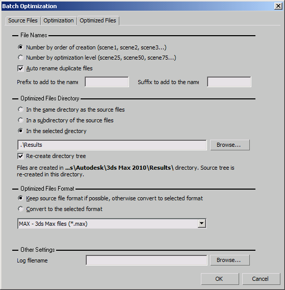

Optimized Files Tab
File Names Section
BatchProOptimizer.DestFileNameMode : integer : Read|Write
Get/set the internal integer value equivalent to the File Name Mode radio buttons selection.
0 - Number by order of creation (scene1, scene2, scene3...)
1 - Number by optimization level (scene25, scene50, scene75...)
BatchProOptimizer.AutoRename : bool : Read|Write
Get/set the internal Boolean value equivalent to the "Auto rename duplicate files" checkbox.
BatchProOptimizer.DestFileNamePrefix : string : Read|Write
BatchProOptimizer.DestFileNameSuffix : string : Read|Write
Optimized Files Directory Section
BatchProOptimizer.DestFolderMode : integer : Read|Write
Get/set the internal integer value equivalent to the Optimized Files Directory mode radio buttons selection.
0 - In the same directory as the source files
1 - In a subdirectory of the source files
2 - In the selected directoty(default)
BatchProOptimizer.DestFolderName : string : Read|Write
Get/set the name of the destination folder to use when .DestFolderMode is set to 1 or 2. Default is ".\Results" which is a relative directory to the currently optimized file's path.
BatchProOptimizer.RecreateFolderTree : bool : Read|Write
Get/set the internal Boolean value equivalent to the "Re-create directory Tree" checkbox.
Optimized Files Format Section
BatchProOptimizer.DestFormatMode : integer : Read|Write
Get/set the internal integer value equivalent to the Optimized Files Format mode radio buttons selection.
0 - Keep source file format if possible, otherwise convert to selected format (default)
1 - Convert to the selected format
BatchProOptimizer.DestFormatExt : string : Read|Write
Get/set the internal string vale defining the file format extension to use. Default is ".obj". Note that the Batch Optimizer uses a drop-down list in the User Interface in interactive mode.
Other Settings Section
BatchProOptimizer.LogFilePath : string : Read|Write
Get/set the file name of the log file. Default is "" (no log).
