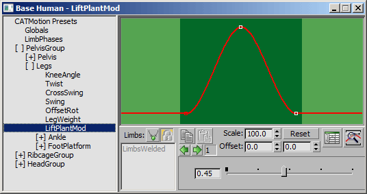

This is a CATMotion controller used in the animation of Limbs in 3ds Max CAT.
Other controllers used for CATMotion Limb Animation include CATKneeAngle : FloatController and CATLegWeight : FloatController.

 <CATLiftPlantMod>.LiftPlantRatio : float
Get/set the Lift Plant Ratio value of the controller.
