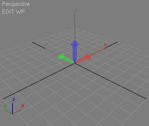

The Axis_Helper is an internal helper object used by the Working Pivot feature to display an Axis Tripod in the scene and allow quick transformations in its coordinate space.
It is not creatable by MAXScript, but is accessible when created by the Working Pivot feature.
