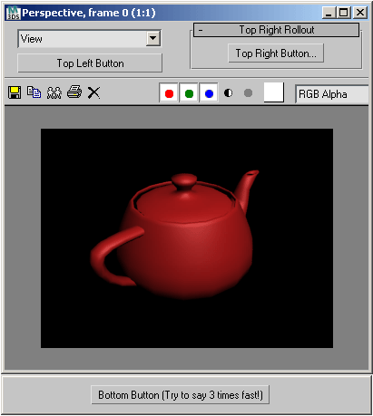

EXAMPLE
The following example REMOVES the original callbacks defined in the file ..\StdPlugs\StdScripts\VFB_Methods.ms and defines new rollouts for the rollout panels.

--Definesome stand-in rollouts to display in the three panels:
rollout theTopLeftRollout "Top Left Rollout" width:200 height:45 (
dropdownlist ddl_topLeft items:#("View","Region","Crop") width:160
button btn_topLeft "Top Left Button" width:160 )
rollout theTopRightRollout "Top Right Rollout" width:200 height:50(
button btn_topLeft"Top Right Button...")
rollout theBottomRollout "Bottom Rollout" width:200 height:22(
button btn_bottomButton "Bottom Button (Try to say 3 times fast!)"
--Initialize the top left panel to a size and
--get its RolloutFloater value back:
theTopLeftFloater = VFB_Interface.InitRolloutWindow #TopLeft 200 60
--Add the rollout to the RolloutFloater without borders and tile bar:
addRollout theTopLeftRollout theTopLeftFloater border:false
--and enable the visibility of the top left panel:
VFB_Interface.SetRolloutWindowVisible #TopLeft true
--Initialize the top right panel to a size and
theTopRightFloater = VFB_Interface.InitRolloutWindow #TopRight 200 60
--add the rollout to the RolloutFloater WITH borders and tile bar:
addRollout theTopRightRollout theTopRightFloater border:true
VFB_Interface.SetRolloutWindowVisible #TopRight true
--Initialize the bottom panel to a size and
theBottomFloater = VFB_Interface.InitRolloutWindow #Bottom 400 35
--add the rollout to the RolloutFloater without borders and tile bar:
addRollout theBottomRollout theBottomFloater border:false
VFB_Interface.SetRolloutWindowVisible #Bottom true
VFB_Interface.InitLayout() --finally, initialize the new layout
