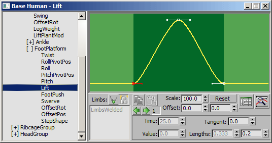

 <CATFootLift>.Amount : float
Get/set the foot lift amount.
Foot Lift Tangent
 <CATFootLift>.LiftTangent : float
Get/set the foot lift tangent value.
 <CATFootLift>.LiftTanLength (LiftTanLen) : float
Get/set the foot lift tangent length value.
Foot Peak Tangent
 <CATFootLift>.PeakTangent : float
Get/set the peak tangent value.
 <CATFootLift>.PeakInTanLength (PeakInTanLen) : float
Get/set the peak in tangent length value.
 <CATFootLift>.PeakOutTanLength (PeakOutTanLen) : float
Get/set the peak out tangent length value.
 <CATFootLift>.PeakTime : float
Get/set the peak time value.
Foot Plant Tangent
 <CATFootLift>.PlantTangent : float
Get/set the plant tangent value.
 <CATFootLift>.PlantTanLength (PlantTanLen) : float
Get/set the plant tangent length value.
