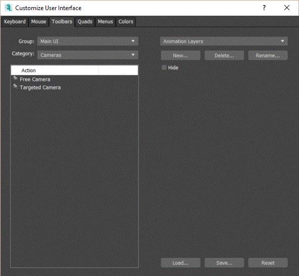

EXAMPLES:
macroScript Free_Camera category:"Cameras" tooltip:"Free Camera"
Icon:#("Cameras",2)
  StartObjectCreation FreeCamera
macroScript Target_Camera category:"Cameras"
tooltip:"Targeted Camera" Icon:#("Cameras",1)
  StartObjectCreation TargetCamera
Since 3ds Max 2011, the strings defining the name properties of the MacroScript definition can be replaced with localized Resources strings whose definitions are enclosed in tildes. Please see the Resources String Replacement topic for details.
After MAXScript evaluates a macroScript construct, the MacroScript definition shows up in the appropriate category list in the Customize User-Interface dialog. The following figure shows a Customize User Interface dialog containing the previous two MacroScripts.
If a tooltip is specified, that tooltip is the name shown in the Customize User Interface dialog. If a tooltip is not specified, <name> is the name shown. Unlike other similar constructs (Scripted Utilities, Functions, and right-click menus), macroScript does not create a variable with this name. Rather, MacroScripts are stored as pointers into files, as described below.

The category: argument specifies in which category of the Customize User-Interface dialog the MacroScript name is listed. The use of categories is intended to help you organize your MacroScripts into groupings so that the MacroScript names are less likely to clash. If you do not specify a category, a default category of "unknown" is used.
