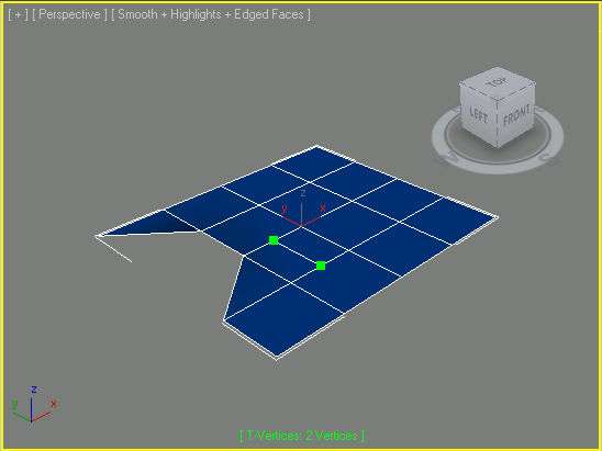

The TVerts Core Interface exposes methods for controlling the T-Vertices xViewChecker which visualizes vertices at T-shaped edgesin Poly objects.
Any vertex with three outgoing edges is considered a T-Vertex regardless of the angle between the edges. T-Vertices are typically found where the flow of an edge loop is interrupted by a full polygon.

<enum>TVerts.Check <time>time <node>nodeToCheck <&index array>results
Check enums: { #Failed|#Vertices|#Edges|#Faces}
results is In and Out parameter
Performs a T-Vertices geometry check at the given time on the specified node and returns its results in the array passed by-reference as third argument.
The method itself always returns the #vertices enum because the values written to the results array always represent the indices of vertices.
