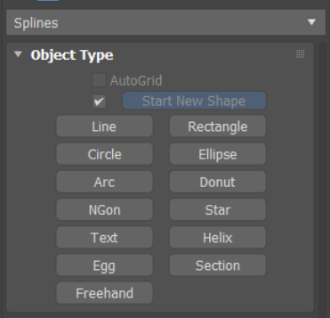

Ellipse : Shape
Ellipse - superclass: shape; super-superclass:node - classID: #(4247, 0)
Value > MAXWrapper > Node > GeometryClass > Shape > Ellipse
Constructor
ellipse...
