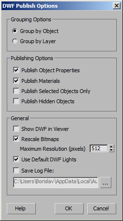

The DwfExportPreferences Core Interface exposes the settings of the DWF Export Dialog to MAXScript.
Available in 3ds Max 2014 and higher.
Interface: DwfExportPreferences
Properties:
.groupBy : enum : Read|Write
groupBy enums: {#ByObject|#ByLayer}
Get/set the state of the "Grouping Options" radio buttons.
You can either use the enums or 0-based integers.
Possible values are:
0 - #ByObject - Group By Object
1 - #ByLayer - Group By Layer
.exportProperties : boolean : Read|Write
Get/set the state of the "Publish Object Properties" checkbox.
Default is True.
.exportMaterials : boolean : Read|Write
Get/set the state of the "Publish Materials" checkbox.
Default is True.
.selectedOnly : boolean : Read|Write
Get/set the state of the "Publish Selected Objects Only" checkbox.
Default is False.
.exportHidden : boolean : Read|Write
Get/set the state of the "Publish Hidden Objects" checkbox.
Default is False.
.showViewer : boolean : Read|Write
Get/set the state of the "Show DWF In Viewer" checkbox.
Default is False.
.rescaleTextures : boolean : Read|Write
Get/set the state of the "Rescale Bitmaps" checkbox.
Default is True.
.maxTextureSize : integer : Read|Write
Get/set the value of the "Max.Resolution (pixels)" spinner used when DwfExportPreferences.rescaleTextures is set to True.
Default value is 512.
.defaultDwfLights : boolean : Read|Write
Get/set the state of the "Use Default DWF Lights" checkbox.
Default is True.
.writeLogFile : boolean : Read|Write
Get/set the state of the "Save Log File" checkbox.
Default is False.
.logFileName : filename : Read|Write
Get/set the file name of the log file used when DwfExportPreferences.writeLogFile is set to True.
Default value is "C:\Users\<UserName>\AppData\Local\Autodesk\3dsMax\<MaxVersion> - 64bit\ENU\en-US\plugcfg\DWF_export.log" where <UserName> is the name of the user and <MaxVersion> is the 3ds Max version number, for example, "2014".
Methods:
<void>ResetDefaultPreferences()
Resets all parameters to the default settings.
<void>SavePreferences()
Saves the current settings as preferences.
The saved settings can be recalled at a later point by calling the following method:
<boolean>LoadPreferences()
Restores the previously saved settings.
