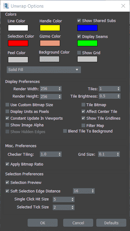

UnwrapUVW Modifier - Preferences Dialog
Colors
Methods:
<point3><Unwrap_UVW>.getLineColor()
Returns the color of the lines used to connect the texture vertices edges as a Point3 value.
Exposed via unwrap interface in 3ds Max 4 and higher.
<void><Unwrap_UVW>.setLineColor <point3>color
Sets the line color of the texture vertices.
<point3><Unwrap_UVW>.getHandleColor()
Returns the handle color.
Exposed via unwrap2 interface in 3ds Max 5 and higher.
<void><Unwrap_UVW>.setHandleColor <point3>color
Sets the handle color.
<boolean><Unwrap_UVW>.getShowShared()
Returns whether shared sub objects are displayed. Shared sub objects are texture vertices or edges that share the same geometric vertex or edge.
<void><Unwrap_UVW>.setShowShared <boolean>select
Sets whether shared sub objects are displayed. Shared sub objects are texture vertices or edges that share the same geometric vertex or edge.
<point3><Unwrap_UVW>.getSharedColor()
Returns the color that will be used to show shared sub objects.
<void><Unwrap_UVW>.setSharedColor <point3>color
Sets the color that will be used to show shared sub objects.
<point3><Unwrap_UVW>.getSelectionColor()
Returns the texture vertices selection color as a Point3 value.
<void><Unwrap_UVW>.setSelectionColor <point3>color
Sets the color of selected texture vertices.
<point3><Unwrap_UVW>.getFreeFormColor()
Returns the Free Form Gizmo color.
<void><Unwrap_UVW>.setFreeFormColor <point3>color
Sets the Free Form Gizmo color.
<point3><Unwrap_UVW>.getOpenEdgeColor()
Returns the color used to display Open Edges.
<void><Unwrap_UVW>.setOpenEdgeColor <point3>color
Sets the color used to display Open Edges.
<point3><Unwrap_UVW>.getBackgroundColor()
Returns the Background color.
<void><Unwrap_UVW>.setBackgroundColor <point3>color
Sets the Background color.
Fill Mode
Methods:
<integer><Unwrap_UVW>.getFillMode()
Returns the polygon fill mode:
<void><Unwrap_UVW>.setFillMode <integer>mode
Sets the polygon fill mode.
Open Edges Display
Methods:
<boolean><Unwrap_UVW>.getDisplayOpenEdges()
Returns the state of the Display Seams option.
<void><Unwrap_UVW>.setDisplayOpenEdges <boolean>displayOpenEdges
Sets the state of the Display Seams option.
<boolean><Unwrap_UVW>.getOpenEdgeMode()
Returns the OpenEdge Mode.
<void><Unwrap_UVW>.setOpenEdgeMode <boolean>uvOpenMode
Sets the OpenEdge Mode.
<void><Unwrap_UVW>.openEdgeSelect()
Selects Open Edges. Select any number of edges and call this method to select all open edges which share texture vertices with the original selection.
Display Preferences
Methods:
<boolean><Unwrap_UVW>.getBrightnessAffectsCenterTile()
Returns the state of the "Affect Center Tile" option in the Display Preferences section of the Unwrap Options dialog.
<void><Unwrap_UVW>.setBrightnessAffectsCenterTile <boolean>bright
Sets the state of the "Affect Center Tile" option in the Display Preferences section of the Unwrap Options dialog.
When set to true , the brightness value affects the center tile.
<boolean><Unwrap_UVW>.getBlendTileToBackground()
Returns the state of the "Blend Tile To Background" option in the Display Preferences section of the Unwrap Options dialog.
When true , the brightness value affects the center tile.
<void><Unwrap_UVW>.setBlendTileToBackground <boolean>blend
Sets the state of the "Blend Tile To Background" option in the Display Preferences section of the Unwrap Options dialog.
When set to true , the tiled images are blended to the background color or black
<boolean><Unwrap_UVW>.getFilterMap
Gets the state of the "Filter Map" option in the Display Preferences section of the Unwrap Options dialog. Available in 3ds Max 2020.2 Update and higher.
<void><Unwrap_UVW>.setFilterMap <boolean>filter
Sets the state of the "Filter Map" option in the Display Preferences section of the Unwrap Options dialog. When true, maps are smoothed/filtered. Available in 3ds Max 2020.2 Update and higher.
Map Tiling
Methods:
<boolean><Unwrap_UVW>.getTileMap()
Returns true if the map is tiled, false otherwise.
<void><Unwrap_UVW>.setTileMap <boolean>tile
Enable/Disable the map tiling.
<integer><Unwrap_UVW>.getTileMapLimit()
Returns the map tiling limit. Corresponds to the Tile Limit value found in the Options panel and Advanced Options dialog.
The value defines how many times to repeat the map outside of the original map area.
<void><Unwrap_UVW>.setTileMapLimit <integer>limit
Sets the map tiling limit.
Corresponds to the Tile Limit value found in the Options panel and Advanced Options dialog. The value defines how many times to repeat the map outside of the original map area.
<float><Unwrap_UVW>.getTileMapBrightness()
Returns the Brightens of the tiled map outside of the original map area.
<void><Unwrap_UVW>.setTileMapBrightness <float>contrast
Sets the Brightens of the tiled map outside of the original map area.
Grid
Methods:
<float><Unwrap_UVW>.getGridSize()
Returns the Grid Size.
<void><Unwrap_UVW>.setGridSize <float>size
Sets the Grid Size.
<boolean><Unwrap_UVW>.getGridSnap()
Returns the state of the Grid Snap checkbutton. Always returns false if the Snap flyout is in Pixel Snap mode.
<void><Unwrap_UVW>.setGridSnap <boolean>snap
Sets the state of the Grid Snap checkbutton. Changes the flyout to Grid Snap if necessary.
<boolean><Unwrap_UVW>.getGridVisible()
Returns the visible state of the Grid.
<void><Unwrap_UVW>.setGridVisible <boolean>visible
Sets the visible state of the Grid.
<point3><Unwrap_UVW>.getGridColor()
Returns the Grid color.
<void><Unwrap_UVW>.setGridColor <point3>color
Sets the Grid color.
<float><Unwrap_UVW>.getGridStr()
Returns the strength of the grid snap.
At a strength of 1 the snap system has complete control and a vertex will always snap to a grid intersection, at a strength of 0 there will be no snapping.
<void><Unwrap_UVW>.setGridStr <float>str
Sets the strength of the grid snap.
Hit Size
Methods:
<integer><Unwrap_UVW>.getHitSize()
Returns the Single Click Hit Size value found in the Advanced Options dialog.
<void><Unwrap_UVW>.setHitSize <integer>size
Sets the Single Click Hit Size value found in the Advanced Options dialog.
Tick Size
Methods:
<integer><Unwrap_UVW>.getTickSize()
Returns the selected vertex tick size.
<void><Unwrap_UVW>.setTickSize <integer>size
Sets the selected vertex tick size.
