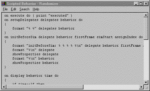

Edit MaxScript
This button "Edit MaxScript", in the Scripted Behavior Rollout opens a MAXScript editor window that can be used to enter a scripted behavior script. The editor window is similar to other MaxScript editor window, but is slightly customized for scripted behaviors.
The following elements in the File Menu work differently:
New: disabled as only one editor per scripted behavior can be open at any time.
Open: opens a file in the existing editor window. Any existing text will be lost.
Evaluate: evaluates the script and saves it into the behavior's paramblock.
Close: saves into the behavior's paramblock and closes the editor if no errors are found.
