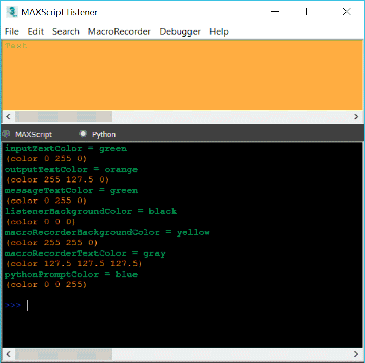

inputTextColor
Lets you get and set a Color value defining the color of typed input text in the MAXScript Listener.
messageTextColor
Lets you get and set a Color value defining the color of error message text in the MAXScript Listener.
listenerBackgroundColor
Gets or sets the background color of the MAXScript Listener. When this value is changed, the caret color changes between black and white as necessary to remain visible. Available in 3ds Max 2020 and higher.
macroRecorderBackgroundColor
Gets or sets the background color of the macro recorder pane. When this value is changed, the caret color changes between black and white as necessary to remain visible. Available in 3ds Max 2020 and higher.
macroRecorderTextColor
Gets or sets the color of text in the macro recorder pane. Available in 3ds Max 2020 and higher.
pythonPromptColor
Gets or sets the color of the prompt in the MAXScript Listener when it is in Python language mode. Available in 3ds Max 2020 and higher.

outputTextColor
Lets you get and set a Color value defining the color of output text in the MAXScript Listener.
EXAMPLE
