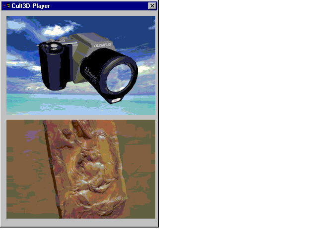

Here is a sample script that creates two instances of a Cult3D viewer found at www.cycore.com, and opens two files from the internet. Install the Cult3d Viewer and execute the script example below. After executing the script right click on any of the viewports and pick "Views > Extended > Cult3D Player" to display the window in the viewport.
EXAMPLE
rollout rCult3D "Cult3D Player"
activeXControl ax1 "{31B7EB4E-8B4B-11D1-A789-00A0CC6651A8}" align:#left setupEvents:false pos:[10,10]
activeXControl ax2"{31B7EB4E-8B4B-11D1-A789-00A0CC6651A8}"align:#left setupEvents:false pos:[10,220]
on rCult3D resized size do
localcsz = (size - [20,30])*[1,.5]
ax2.pos = [10, csz.y+20]
ax1.size = ax2.size = csz
on rCult3D open do
ax1.size = ax2.size = [300,200]
ax1.LoadCult3D"http://www.cult3d.com/gallery/ecommerce/olympus_on_the_beach.co"
ax2.LoadCult3D"http://www.cult3d.com/gallery/museum/madonna.co"
createDialog rCult3D width:320 height:430
registerViewWindow rCult3D
