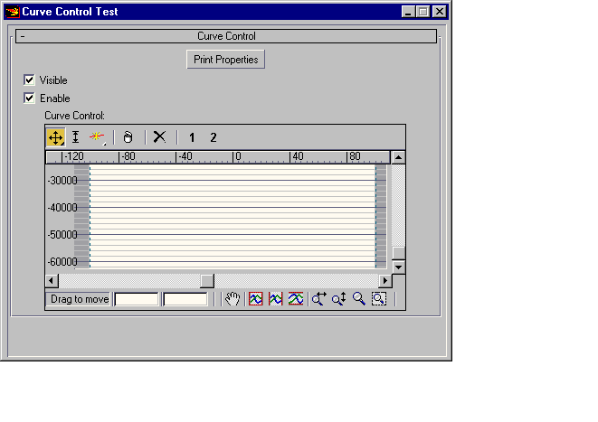

EXAMPLE
rollout uTestCurveControl "Curve Control"
-- Curve control Properties
local ccProps = #(
#visible,

button btn_props "Print Properties"
checkBox chk_visible "Visible" checked:true
checkBox chk_enable "Enable" checked:true
CurveControl cc_test "Curve Control:"
height:200
width:400
align:#center
numCurves:2
visible:true
x_range:[-100,100]
y_range:[-100,100]
scrollValues:[-100,100]
commandMode:#move_xy
-- The following parameters default to all flags if not specified
--uiFlags:#(#drawBG, #drawgrid, #upperToolbar, #showReset, #scrollBars, #constrainY, #xvalue)
rcmFlags:#(#delete)
asPopup:false
on chk_visible changed state do cc_test.visible = state
on chk_enable changed state do cc_test.enabled = state
on uTestCurveControl open do
zoom cc_test #all
local colors = #(red, green, blue)

curveFloater = newRolloutFloater "Curve Control Test" 500 400
addRollout uTestCurveControl curveFloater
