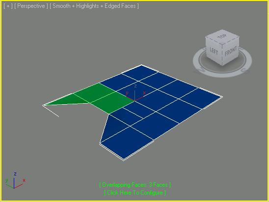

The OverlappingFaces Core Interface exposes methods for interacting with the Overlapping Faces xView Checker.

Performs an Overlapping Faces xView check at the given time on the specified node and returns its results in the array passed by-reference as third argument.
The method itself always returns the #faces enum because the values written to the results array always represent indices of overlapping faces.
