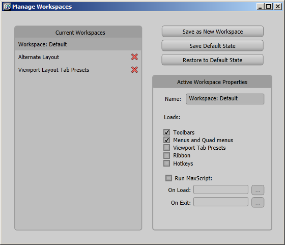

The WorkspaceManager Core Interface exposes the features of the Manage Workspaces dialog to MAXScript.

<bool>WorkspaceManager.IsSubsystemSaving <string>identifier <string>subSystemIdentifier
Returns True if the sub-system specified by name by the first argument will be saved when the Workspace with the identifier given by the second argument is saving, False otherwise.
<bool>WorkspaceManager.ToggleSubsystemSaving <string>identifier <string>subSystemIdentifier
Toggles whether the indexed sub-system specified by the first argument will be saved when the Workspace with the identifier given by the second argument is saving.
Returns the new saving state.
<bool>WorkspaceManager.IsSystemWorkspace <string>identifier
Returns True if the Workspace specified by the given identifier is a system workspace, False if it is not.
