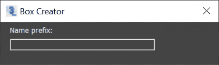

EXAMPLE:
rollout boxCreator "Box Creator"
	--define an edittextwith width 100 and the label on top:
	edittext prefix_txt "Name prefix:" fieldWidth:200 labelOnTop:true
	--If the user entered a new name...
	on prefix_txt entered txt do
	--And the name is not the empty string,
	if txt != "" do
		--Create a new box at a random position
		--somewhere between the given coordinates:
		new_obj = box pos:(random [-100,-100,-100] [100,100,100])
		--Set the name of the new object to the prefix entered,
		--but add unique suffix to avoid duplicate names:
		new_obj.name = (uniquename txt)
		--And finally clear the edittext for a new entry
		--by assigning an empty string to the text property:
		prefix_txt.text = ""
createDialog boxCreator 300 60 --create a Dialog from the rollout
