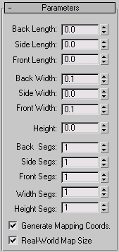

Specify the length of each of the three sides.
Specify the width of each of the three sides.
Specifies the overall height of the object.
Specify the number of segments for a specific side of the object.
Set these to specify the number of segments for the overall width and height of the object.
Sets up the required coordinates for applying mapped materials to the object. Default=on.
Controls the scaling method used for texture mapped materials that are applied to the object. The scaling values are controlled by the Use Real-World Scale settings found in the applied material's Coordinates rollout. Default=off.
