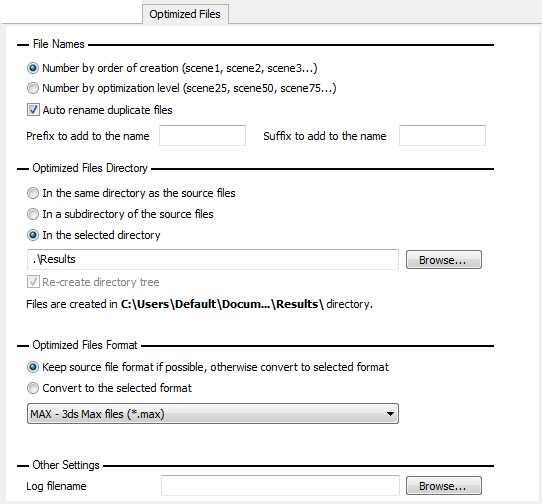

On the Optimized Files panel, you choose the location of the generated files, their file name format, and file format.
These options tell ProOptimizer how to name the files it generates.
When on, ProOptimizer renames each file it generates if there is a conflict with the name of an exisiting file. When off, ProOptimizer overwrites existing files that have the same name. Default=on.
Lets you specify a prefix to add to the name of all files generated by ProOptimizer.
Lets you specify a suffix to add to the name of all files generated by ProOptimizer.
These options tell ProOptimizer where to save the files it generates.
When you choose either a subdirectory or specify a particular directory, this field shows the name of the directory used. Default=”.\Results”.
Browse When “In the selected directory” is active, click Browse to display a directory browser that lets you choose the folder in which to save the optimized files.
When on, and “In the selected directory” is active, ProOptimizer creates subdirectories that match the original source tree. When “In a subdirectory of the source files” is active, this option is always on. Default=on.
This option is disabled if you turn off Include Subdirectories on the Source Files panel.
With these options, you can choose the format of the generated files.
[file format drop-down list] Lets you choose between MAX (3ds Max) or OBJ (Wavefront) file formats.
Browse Click to choose a folder for the log file. The default location is the location of the current scene.
