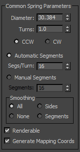

The overall diameter of the spring, as measured at the center of the wire. (The diameter of the wire itself has no effect on this setting.)
The number of full 360-degree turns in the spring.
Specifies whether the coils of the spring are counterclockwise (CCW) or clockwise (CW).
Choose this option to force each turn of the spring to contains the same number of segments, as specified in the Segs/Turn spinner. Thus, if you increase the number of turns, the number of segments also increases.
This spinner lets you specify the number of segments in each 360-degree turn of the spring.
When this option is chosen, the length of the spring contains a fixed number of segments, no matter how many turns in the spring. Thus, as you increase the number of turns, you must manually increase the number of segments to maintain a smooth curve.
This spinner lets you specify the total number of manual segments in the spring.
Provides various methods of smoothing the object. The options here work the same as those in the Torus primitive.
When on, the object appears in the rendering; when off, the object does not appear.
Assigns mapping coordinates to the object. Default=on.

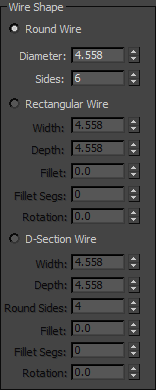

Provides three different types of wire cross-sections for the spring: round, rectangular, or D-shaped. Each type has its own set of parameters.
Specifies a round wire for the spring.
Specifies a rectangular wire.
Specifies a D-shaped wire.
