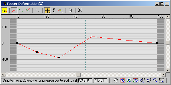

Teeter deformation curve dialog

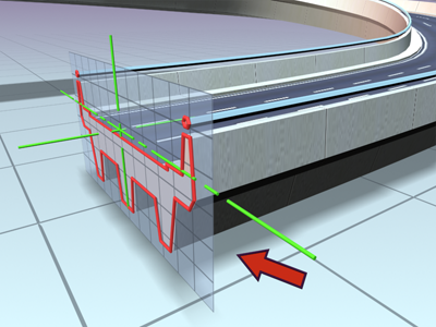

Roadway lofted with no teeter

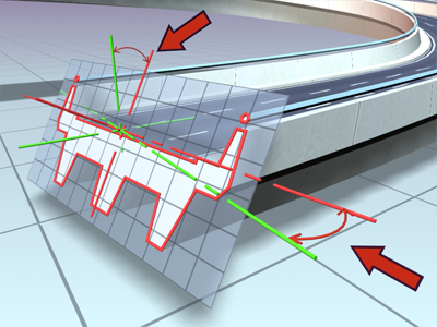

Roadway lofted with teeter turned on. Teeter affects the X and Y axis orientation of the shape in relation to the path.
These are the properties of Teeter deformation curves:
See Deformation Dialog for specific information on the dialog controls.
