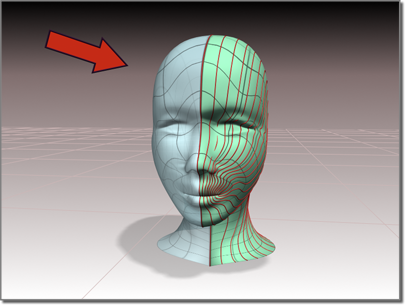

Surface created as a mirror
To create a mirror surface:
The NURBS object must contain at least one surface.
The mirror surface is created. A gizmo (yellow by default) indicates the direction of mirroring. Transforming the mirror surface's gizmo changes the orientation of the mirror, letting you mirror along an axis that isn't aligned with a local coordinate axis.
