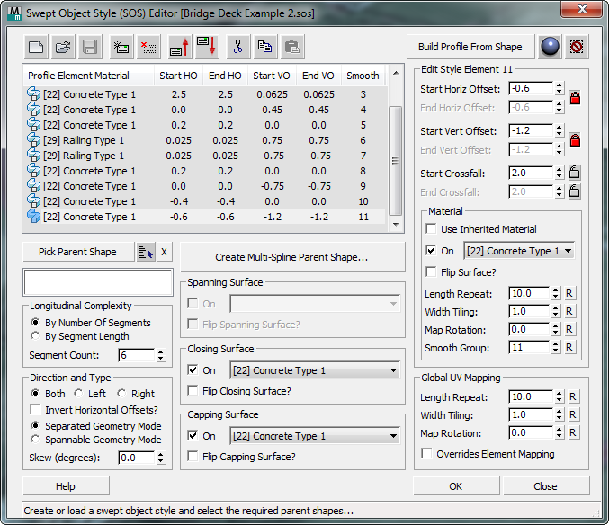

A swept object definition can be saved to a text-based Swept Object Style (SOS). Each style contains a set of elements. Each element represents a single surface within the swept object. Each element features adjustable (and variable) horizontal and vertical offsets and an independent material channel definition. By default, swept objects use the CivilViewSurfaces material.

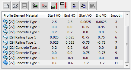

Lists the contents of the current swept object style. Each line shows an individual element in the list. Highlighting an element displays its details in the remaining controls on the editor.
Start New Style
Open Style
Save Style
Add new element
Delete selected element
Move selected element up
Move selected element down
Cut Element
Copy Element
Paste ElementYou can paste a Cut element to a different location in the current style, and you can paste a Cut or Copied element to a different SOS.

[pick by name] Click to open a dialog (similar to Select Objects) that lets you pick shapes by name. Swept Object Styles can be applied to either single or multiple shapes. Each parent shape can consist of one or more splines. If a swept object style is applied to multiple parent shapes, parameter instancing is automatically applied to help make sure that a single set of parameters is shared across all resulting swept objects.
Affects the complexity of the resulting swept object. Higher values result in more complex object geometry.
It is best to use the lowest possible value in this spinner, but the precise value to be used depends on the geometry of the parent shapes.
If you choose either Left or Right, the Spanning, Closing, and Capping Surface controls are disabled.
When on, reverses the direction of all horizontal offsets in the swept object profile. Default=off.
This choice is useful for creating walls and noise barrier profiles, where potential gaps between splines represent gaps in the wall or barrier.
This choice is useful for creating bridge decks that need to span a gap between two or more splines in a parent shape.
When equal to 0.0, profiles are offset at a normal from the direction of the parent shape. Nonzero values are useful for objects such as asymmetrical bridge decks.
A spanning surface is an optional surface "draped" across the gap between the parent splines. This can be useful for creating an asphalt surface over a bridge deck.
Not available if you have chosen Left or Right in the Profile Direction And Type group (see above).
A closing surface is an optional surface "draped" across the gap between the final surfaces of the swept object. This is useful for creating the underside of a bridge deck.
Available only if there is more than one parent shape, and the parent shapes are arranged in a way that permits Civil View to construct the closing surface. See Build New Parent Shape Dialog.
Not available if the chosen construction method is Separated Geometry Mode (see above).
A capping surface closes or caps the open ends of the swept object.
Not available if the chosen construction method is Separated Spline Geometry (see above).

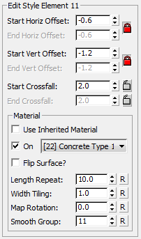

Edits the settings of the element currently highlighted in the SOS element list. Each element represents a single surface in the swept object, and features a horizontal and vertical offset, along with an independent material channel selection.
Lock Start and End Horizontal Offsets Click to lock or unlock the Start and End values. When values are unlocked, the horizontal offset can vary along the length of the swept object. Default = locked.
Lock Start and End Vertical Offsets Click to lock or unlock the Start and End values. When values are unlocked, the vertical offset can vary along the length of the swept object. Default = locked.
[lock Start/End Crossfall] Click to lock or unlock the Start and End values. When the Start Crossfall or End Crossfall value is locked, changing the Vertical Offset does not affect this value; otherwise, it does. Default = unlocked. Turning this on disables the other settings in the Material group, except for Smoothing Group.
Gap elements create an invisible offset between the parent shape and the first surface in the swept object. Gap elements are displayed as "[Gap]" in the Swept Object Style element list.
Sets the distance over which the selected material is repeated along the element. Default = 10.0 world units.
This option is valid only for tileable texture maps, and is ignored when used with procedural texture maps.
Sets the number of times the selected material is repeated across the width of the element. Default = 1.
Sets a rotation to apply to mapping on the element.
Sets the smoothing group ID used by the element. By default, the smoothing group is incremented by one when you add a new element to the profile.
Valid smoothing group IDs are values between 1 and 32. A value of 0 can also be specified: This prevents any longitudinal smoothing to be applied to any single profile element.
