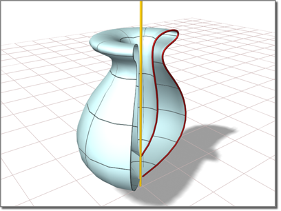

Sets the angle of rotation. At 360 degrees (the default), the surface completely surrounds the axis. At lower values, the surface is a partial rotation.
A partial lathe (degrees=225)

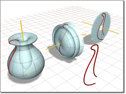

X, Y, and Z rotations of the same curve
These buttons position the axis of rotation relative to the curve.
(The default.) Locates the lathe axis at the curve's negative local X-axis boundary.
Locates the lathe axis at the curve's center.
Locates the lathe axis at the curve's positive local X-axis boundary.
Min, Center, and Max lathes of the same curve

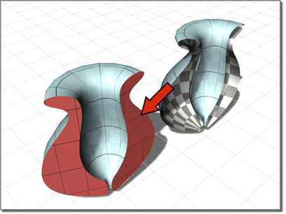

Lets you flip the surface normals at creation time. (After creation, you can flip normals using controls on the Surface Common rollout.)
When on, two surfaces are generated to close the ends of the lathe. While they are present, the cap surfaces are maintained so they match the dimensions of the lathe surface. The lathe must be a 360-degree lathe.
The Cap checkbox appears only on the creation rollout. If you want to remove the caps later, simply select them as surface sub-objects and delete them. Think of lathe capping as a workflow shortcut rather than a property (or parameter) of lathe surfaces.
To flip the normal of a lathe cap, select it as a Surface sub-object and use the Flip Normals toggle on the Surface Common rollout.
