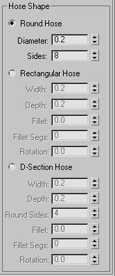

Sets the shape of the hose cross section. Default=Round Hose.
Sets a circular cross section.
Lets you specify different settings for width and depth.
Similar to Rectangular Hose, but rounds one side for a D-shaped cross-section.
