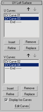

While a UV Loft sub-object is selected, a rollout with the UV loft parameters appears. This rollout appears only when one UV loft sub-object is selected. It isn’t possible to edit more than one UV loft at a time, so unlike some other NURBS sub-objects, the rollout doesn’t appear when multiple UV loft sub-objects are selected.
These lists show the names of the curves you click, in the order you click them. You can select a curve by clicking its name in a list. Viewports display the selected curve in blue.
The two buttons above and the four below each list are identical for both lists.

Use these to change the order of curves in the U Curve or V Curve list. Select a curve in the list, and then use the arrows to move the selection up or down.
(Disabled.)
Removes a curve from the U list or V list. Select the curve in the list, and then click Remove.

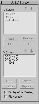

When on, the UV loft surface is displayed while you create it. When off, the loft can be created more quickly. Default=off.
Reverses the direction of the UV loft's normals.
Adds a curve to the U list or V list. Click to turn on Insert, then click the curve. The curve is inserted before the selected curve. To insert a curve at the end, first highlight the "----End-----" marker in the list.
Refines the UV loft surface. Click to turn on Refine, then click an iso curve on the surface. (As you drag the mouse over the surface, the available curves are highlighted.) The curve you click is converted to a CV curve and inserted into the loft and the U Curves or V Curves list. As when you refine a point curve, refining a UV loft can change the curvature of the surface slightly. Once you’ve refined the surface by adding a U curve or V curve, you can use Edit Curves to change the curve.
Lets you replace the selected curve. Select a curve in the list, click this button, then select the new curve.
When set, the UV loft’s iso curves are displayed as well as the U-axis and V-axis curves used to construct the loft. The iso curves are only for display. You can’t use them for surface construction.
Lets you edit the currently selected curve without switching to another sub-object level. Click to turn on Edit Curve. The points or CVs of the curve are displayed, as well as the control lattice if the curve is a CV curve. You can now transform or otherwise change the points or CVs as if you were at the Point or Curve CV sub-object level. To finish editing the curve, click to turn off Edit Curves.
When you turn on Edit Curves, all applicable rollouts for the selected curves are displayed, including the Curve Common rollout, the CV or Point rollout (depending on the curve type), and the CV Curve or Point Curve rollout. These rollouts appear beneath the U Loft rollout. They let you edit the loft curves and their points or CVs without having to switch sub-object levels.
The UV loft surface can deviate from the curve if you edit a curve in a UV loft by increasing the weight of the curve CVs. You can work around this by refining the curve at the point where the surface deviates.
