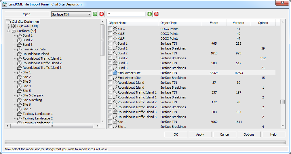

This group of controls provides filtering options to help you select portions of one or more models.
[check-mark button]
[X button]You can also use the file contents list to select strings individually, or right-click the list to see a menu with additional selection options.
[plus-sign button]
[minus-sign button]The list view on the right shows a list of objects that are related to the current tree view selection. A right-click menu lets you select objects from list using a range of criteria such as object type or name.
Some feature labels in the list might appear grayed out. This can happen for a couple of reasons:
Civil View automatically checks all feature and model names against previously imported features. If any identical feature label and model name combination already exists in the current scene, the corresponding list item is disabled.
Every Civil View object derived from MX triangulation data is assigned a primary default material channel that is assigned to any ungrouped or otherwise unidentified triangles. The default material channel for imported surfaces is also defined on the Civil View Preferences_panel.
