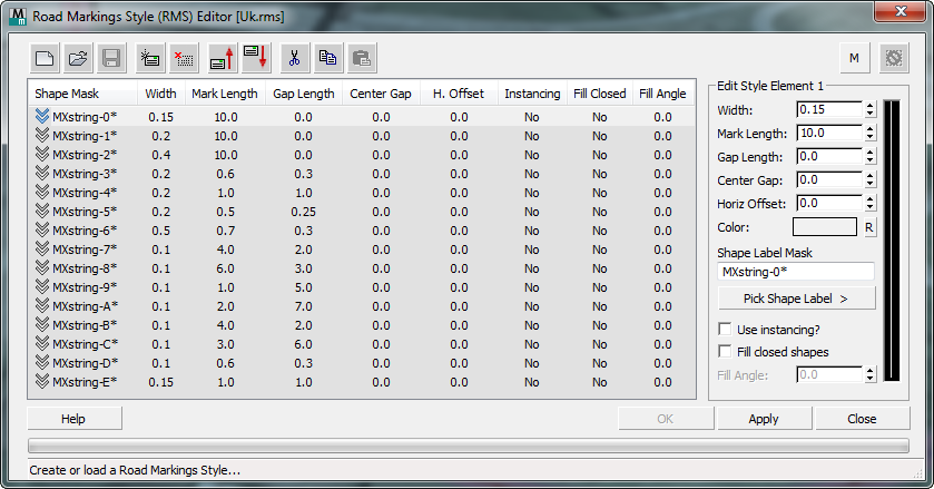

The Road Markings Style Editor lets you apply of a range of road-marking types to a visualization model by associating a road-marking type with a series of shape label masks.
By default, linear road-marking objects use the CivilViewMarkings material.
Lists the contents of the current road marking style. Each line shows an individual element. Click to highlight an element and see its details in the element editor to the right.

Allow multiple markings per shape?Indicates whether more than one road-marking object can be applied to each parent shape. This is a global setting defined in the Civil View Preferences panel. It is off by default. You can overridde this setting locally, for an individual element, by changing the status of this button.
Reset Swept ObjectThe controls in the group to the right let you edit the settings of the highlighted road marking style element.
For filled area "chevron" road markings, this value has no effect.
For filled area road markings, sets the width of the road-marking chevrons or stripes generated across the closed boundary of the parent shape (only valid if Fill Closed Shapes is turned on).
For filled area "chevron" road markings, sets the width of the gap between each chevron or stripe (only valid if Fill Closed Shapes is turned on. If a solid filled area of marking is required, set this value to 0.0.
