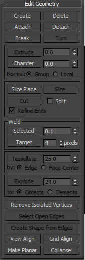

To weld mesh vertices:
You can use either of two methods to combine several vertices into one, also known as welding. If the vertices are very close together, use the Weld function. You can also use Weld to combine a number of vertices to the average position of all of them.
Alternatively, to combine two vertices that are far apart, resulting in a single vertex that's in the same position as one of them, use Target Weld.
Weld group and click Selected. If that doesn't work (you get a No vertices within weld threshold. message), proceed to the next step. This is the threshold value; the minimum distance that vertices can be apart from each other to be welded.
At this point, one of three things happens: None, some, or all of the vertices are welded. If the latter, you're done. If either of the others occurs, proceed to the next step.
For this example, we'll call the vertices A and B, and the resulting vertex will be at vertex B's location.
The button stays highlighted, to indicate that you're now in Target Weld mode.
While you're dragging, the mouse cursor image is a four-headed, +-shaped arrow. When over an eligible target vertex, the cursor changes to a crosshairs.
The pair is welded. The resulting vertex remains at vertex B's position, and you exit Target Weld mode.
You remain in Target Weld mode, and can continue to weld pairs of vertices.
