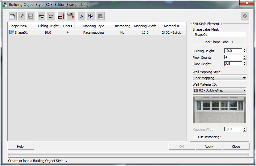

With the Building Object Style Editor, you can apply a building type to a range of buildings by associating the building type with a series of shape label masks.
Various building types in a Civil View scene
By default, building objects use the Material CivilViewBuildings material.
Lists the contents of the BOS style. Each line shows an individual element in the style. You can select an element in the list to display its details in the Edit BOS Element group.
Start New Style
Open Style
Save Style
Add new element
Delete selected element
Move selected element up
Move selected element down
Cut Element
Copy Element
Paste Element
Reset

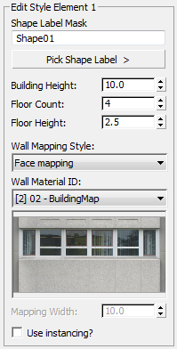

Displays the settings of the building style you have selected in the BOS Element List, and lets you choose the shapes to which the style is applied.
In Civil View, parameter instancing allows parameters to be shared across multiple objects of the same type, even if the resultant geometric shape defined by the parent spline is entirely different.
For building objects, this means that two buildings of the same design can share a single instance of the parameters used to define the height and texture of the building. This is possible even if the floor area of the buildings are different, since it is only the properties of building itself that are instanced: not the geometry of the parent floor area shape.
