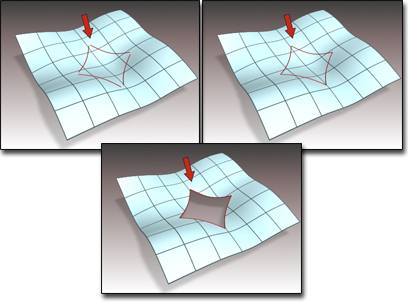

Creating a multicurve trimmed surface
When you create a multicurve trimmed surface, you create only one trimmed hole. If you want to create multiple holes, first create holes in the surface using other techniques, and as the final step create the multicurve trim.
You can't trim across the edge between two surfaces, or across a "seam" where a surface touches itself, as at the back of a spherical surface created by converting a Sphere primitive.
To create a multicurve trim:
The NURBS object must contain a surface with curves on it that create a closed loop.
The curves must form a single closed loop, or completely traverse the surface.
The Trim list shows the names of the curves you select. Flip Trim inverts the direction of trimming. Flip Normals lets you flip the surface normals at creation time. (After you have created the surface, you can flip normals using controls on the Surface Common rollout.)
