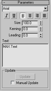

Settings available for text include kerning, leading, justification, multiple lines, and a manual update option.

Once you have created text, you can make changes using the following parameters:
Choose from a list of all available fonts. Available fonts include:
Toggles italicized text.
Toggles underlined text.
Aligns text to the left side of its bounding box.
Aligns text to the center of its bounding box.
Aligns text to the right side of its bounding box.
Spaces all lines of text to fill the extents of the bounding box.
Sets the text height where the height measuring method is defined by the active font. The first time you enter text, the default size is 100 units.
Adjusts the kerning (the distance between letters).
Adjusts the leading (the distance between lines). This has an effect only when multiple lines of text are included in the shape.
Allows for multiple lines of text. Press Enter after each line of text to start the next line. Note the following:
These options let you select a manual update option for situations where the complexity of the text shape is too high for automatic updates.
Updates the text in the viewport to match the current settings in the edit box. This button is available only when Manual Update is on.
When on, the text that you type into the edit box is not shown in the viewport until you click the Update button.
