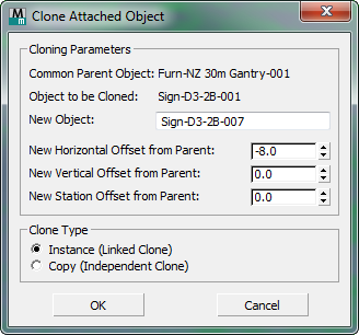

To display the context-sensitive pop-up menu, Ctrl+click an item in the list, or right-click the item.
The content of the pop-up menu varies depending of the type of the object. Examples of the type of operation possible from this menu are:
This choice displays a dialog whose contents depend on the object type.
