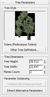

Provides controls for tree objects.
In general, when you use the Object Placement Style Editor to place a series of parametric objects in a single SOS element, the objects are linked as instances. This means that changing any of the following parameters affects all objects in the set. To unlink such instances, please refer to Parameter Instancing.

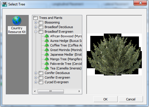

Choosing a tree definition file updates the texture and geometry of the tree object.
In addition to these Height and Width values, Civil View applies a randomization factor in order to vary tree size between each tree of the same type. This vastly improves realism. You can set the percentage variation factor by using the Civil View Preferences panel.
The number of planes (complexity) in the selected tree object.
Allows the parameters of a collection of objects of the same basic type to be shared or instanced.
See Parameter Instancing for further details.
