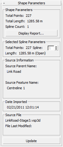

Displays information about imported shape objects, and lets you update a shape.
To understand the information displayed on this rollout, you should understand the difference between shapes and splines in 3ds Max terminology.
Provides a report on the attributes of the selected shape:
The total number of points (vertices) in the shape.
The total length of all splines in the selected shape.
The number of splines in the selected shape.
Provides a report on the attributes of with the currently selected spline. Fields show the length of the spline and the number of points (vertices) it has.
Displays information about the source of the shape.
Shows the date and time on which this object was created.
If this date is later than the date on which the object was imported, the selected object might be out of synch with your current source design data.
This value is blank if the source file cannot be found.
Not available if the original source file is no longer found in the original path.
