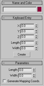

The Name and Color rollout lets you rename objects and change their wireframe color.
Sets the patch center.
Sets the patch length.
Sets the patch width.
Creates a patch based on the XYZ, Length, and Width values.
Sets dimensions of grid in current units.
Creates map coordinates for applying mapped materials. Default=off.
