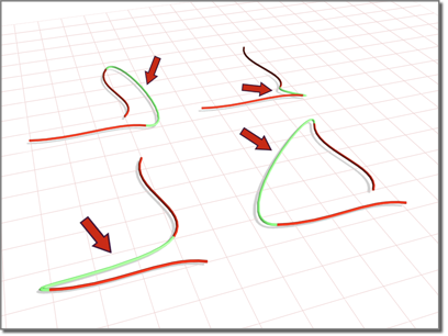

Blend curves connecting original curves
To create a blend curve:
The NURBS object must contain two or more curves.
After the blend curve is created, changing the position or the curvature of either parent curve changes the blend curve as well.
"Tension" affects the tangent between a parent curve and the blend curve. The greater the tension value, the more closely the tangent parallels the parent curve, and the smoother the transition. The lower the tension, the greater the tangent angle and the sharper the transition between parent and blend.
Controls tension at the edge of the first curve you clicked.
Controls tension at the edge of the second curve you clicked.
Let you replace the parent curves. Click the button, then click the curve to replace the original first or second curve.
