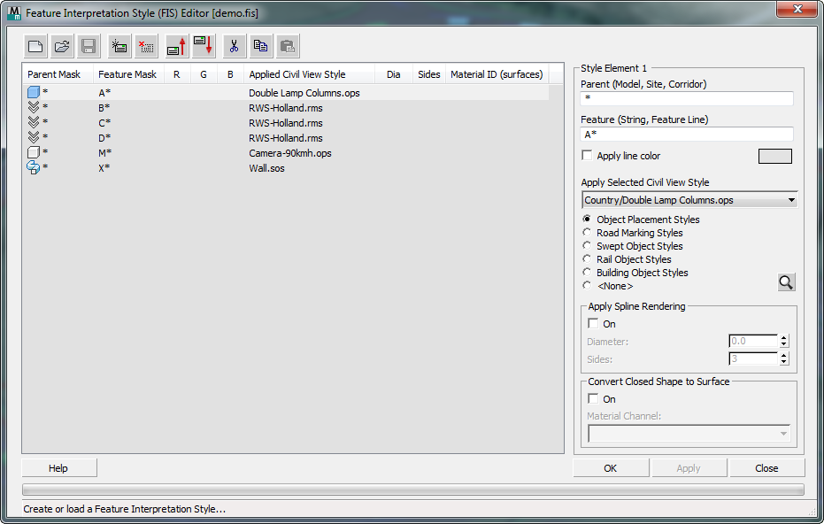

Lets you associate objects from the Civil View Object Libraries with imported shapes such as strings or feature lines.
This feature works in association with the Civil View Geometry Import Panels. Feature Interpretation can be activated from these panels, and direct access to this panel is provided in order to edit these styles.
Lists the contents of the current FIS style. Each line shows an individual element. You can select an element to display its settings in the FIS Element group.
Start New Style
Open Style
Save Style
Add new element
Delete selected element
Move selected element up
Move selected element down
Cut Element
Copy Element
Paste Element

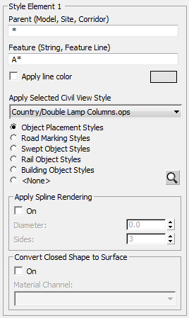

Displays the settings associated with the FIS element selected in the list.
Each style element includes masks for the parent and feature. These let you apply a Civil View style definition to that particular imported feature.
You can also set the line color for imported shapes.
Examples of originating parent references include MX Models, Civil 3D Corridors and Sites, AutoCAD Layers, and Microstation Levels.
Examples of originating feature name references include MX Strings, Civil 3D Feature Lines, and Breaklines.
If you turn off this option, Civil View applies a hard-coded default line color. Line colors affect only the display of shapes in 3ds Max viewports; they have no effect on rendered output.
The list contents are derived from folders in the Civil View Country, Project, and Private Resource Kits. If a style with the same name exists in more than one active resource kit, Civil View matches the first matching style name found in any resource kit in the following order of priority:
Changing this selection changes the list of available styles.
[style preview]You can also view this window by double clicking an element in the main FIS Style list.
By default, imported shape objects are not renderable in a 3ds Max scene. You must create additional geometry along the path of an imported shape (such as road markings or guard rails) in order to see the path of the shape in rendered views.
However, there are occasions when it can be useful to render the shape object itself; for example, when imported shape data represents the cables of a suspended bridge deck. These controls let you make shapes renderable.
When you turn on this option, incoming closed shapes that match a specified feature mask are triangulated automatically. You can also assign a material channel so the surface has the correct texture applied.
This option is particularly useful with some types of survey data where boundaries between different surface types are represented by a series of boundary strings.
