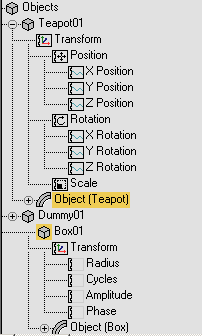

To put other kinds of objects in the ring:
You can use either version of Track View: Curve Editor or Dope Sheet.
The name highlights.
The box or boxes are replaced with the copied object.
Top: Object substituted for boxes in array
Bottom: The result
