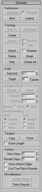

To weld vertices:
The two vertices move together and join.
Welding vertices
