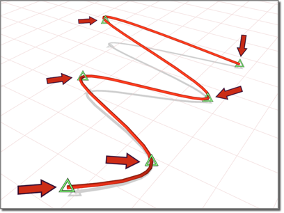

Fitting a curve to selected points
To create a point curve with Curve Fit:
The NURBS object must contain two or more point sub-objects.
A point curve is created. It runs through the points you select, in the order you select them.
You can press Backspace to undo point selection in reverse order.
There are no parameters for a point curve created with Curve Fit.
