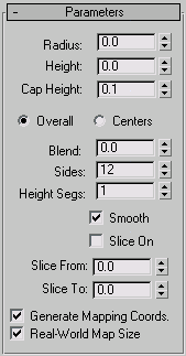

To create an oil tank:
Oil Tank. Draws the object from edge to edge. You can change the center location by moving the mouse.
Draws the object from the center out.
Sets the radius of the oil tank.
Sets the dimension along the central axis. Negative values create the oil tank below the construction plane.
Sets the height of the convex caps. The minimum value is 2.5 percent of the Radius setting. The maximum value is 99 percent the Radius setting, unless the absolute value of the Height setting is less than twice the Radius setting, in which case cap height cannot exceed 49.5 percent of the absolute value of the Height setting.
Determines what the Height value specifies. Overall is the overall height of the object. Centers is the height of the midsection of the cylinder, not including its convex caps.
When greater than 0, creates a bevel at the edge of the caps.
Sets the number of sides around the oil tank. To create a smoothly rounded object, use a higher number of sides and turn Smooth on. To create an oil tank with flat sides, use a lower number of sides and turn Smooth off.
Sets the number of divisions along the oil tank's major axis.
Blends the faces of the oil tank, creating a smooth appearance in rendered views.
Turns on the Slice function. Default=off.
When you create a slice and then turn off Slice On, the complete oil tank reappears. You can therefore use this checkbox to switch between the two topologies.
Sets the number of degrees around the local Z axis from a zero point at the local X axis.
For both settings, positive values move the end of the slice counterclockwise; negative values move it clockwise. Either setting can be made first. When the ends meet, the whole oil tank reappears.
Generates coordinates for applying mapped materials to the oil tank. Default=on.
Controls the scaling method used for texture mapped materials that are applied to the object. The scaling values are controlled by the Use Real-World Scale settings found in the applied material's Coordinates rollout. Default=off.
