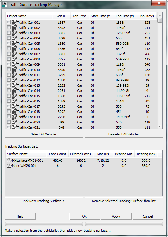

Once surface tracking has been applied, all vehicles accurately "cling" to the height, crossfall, and longitudinal profile of the underlying ground terrain. On this panel, you can assign multiple surfaces to help make sure that vehicles track the surface of bridges, tunnels, and other structural elements as well as the primary ground surface.
Lists all imported traffic in the current scene. Each entry in the list represents a single vehicle object originally generated via Civil View. For each vehicle object, the following information is displayed:
You can click an entry in the list to select that vehicle.

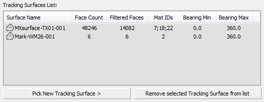

Lists the tracking surfaces that have been picked.

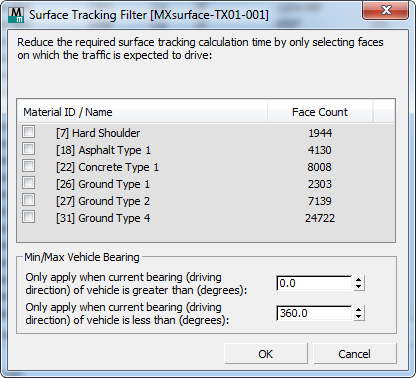

After you select a new tracking surface, Civil View opens a Surface Tracking Filter dialog.
In this dialog, you must select at least one material ID to use. For example, you might want vehicles to track the asphalt portion of a surface but not the shoulder or the ground. Filtering surfaces in this way reduces the time Civil View has to spend on calculating surface tracking.
In this dialog, you can also limit surface tracking to directions (bearings) in which the vehicle is traveling. This can also improve performance.
You can pick multiple surfaces to track. This is particularly important if vehicles must pass over structures such as bridge decks, which do not form part of the underlying primary ground surface.
