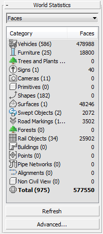

Provides a complete overview of the resources used in the current scene.
Typically, you use this panel to identify groups of objects that might be making heavy use of system resources. When you model in 3D, it is best to keep the face count as low as possible.
Lists the total number of faces used by the objects of each category in the scene.
Lists the total number of vertices used by the objects of each category in the scene.
Lists Civil View object categories and the total number of objects that exist for each category in the current scene.
Depending on your choice from the drop-down list, shows the total number of faces or vertices used by each object category.
