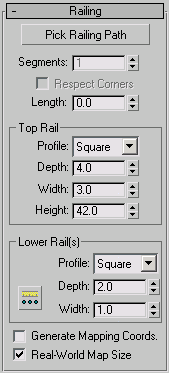

Click this, and then click a spline in the viewport to use as the railing path. 3ds Max uses the spline as the path along which to apply the railing object.
If you edit the spline you’ve used as a railing path, the railing adjusts to the changes you make. 3ds Max doesn’t immediately recognize 2D Shapes from a linked AutoCAD drawing. To recognize Shapes from a linked AutoCAD drawing, edit the Shape with Edit Spline in the Modify panel.
Sets the number of segments of the railing object. Available only when you’re using a railing path.
For a close approximation to a railing path, increase the number of segments. Be aware that a high number of segments increases file size and slows down the rendering speed. You might use fewer segments when the spline path has a low curvature (or none) and fewer segments provide an adequate approximation.
Puts corners in the railing to match the corners of the railing path.
Sets the length of the Railing object. When you drag the mouse, the length displays in the edit box.

Controls the profile, depth, width, and spacing between the lower rails. You specify how many lower rails you want using the Lower Rail Spacing button.
A railing with the rails defined by their profile, depth, and width as planks.
Sets the cross-section shape of the lower rails.
Sets the depth of the lower rails.
Sets the width of the lower rails.
Sets the spacing of the lower rails. When you click this button, the Lower Rail Spacing dialog displays. Specify the number of lower rails you want using the Count option. For more information on spacing options in this dialog, see Spacing Tool.

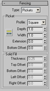

Sets the type of fencing between the posts: none, Pickets, or Solid Fill.
Controls the profile, depth, width, and spacing between the pickets. Specify how many pickets you want using the Picket Spacing button. Available only when you set Type to Pickets.
1. A railing with pickets using a square profile
2. A railing with pickets using a round profile
Sets the cross-section shape of the pickets.
Sets the depth of the pickets.
Sets the width of the pickets.
Sets the amount the pickets extend above the bottom of the top railing.
Sets the amount the pickets are offset from the bottom of the railing object.
Sets the spacing of the pickets. When you click this button, the Picket Spacing dialog displays. Specify the number of pickets you want using the Count option. For more information on spacing options in this dialog, see Spacing Tool.
Controls the thickness and offsets of the solid fill between the posts. Available only when you set Type to Solid.
Sets the thickness of the solid fill.
Sets the offset of the solid fill from the bottom of the top rail.
Sets the offset of the solid fill from the bottom of the railing object.
Sets the offset between the solid fill and the adjacent left post.
Sets the offset between the solid fill and the adjacent right post.
