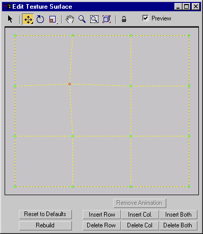

This dialog lets you edit the texture surface for a surface sub-object. It is available when you have chosen User Defined as the sub-object's texture surface method.
A texture surface is associated with the surface sub-object. The texture surface is used to control how materials are mapped. In effect, changing the texture surface stretches or otherwise changes the UV coordinates for the surface, altering the mapping.
The Edit Texture Surface dialog shows a 2D view of the texture surface. You can also edit user-defined texture surfaces directly in 3D viewports, using the Edit Texture Points button. See Material Properties Rollout.
Maps can shift with certain surface approximation methods. This effect is especially noticeable when the surface has animated CVs. You can reduce or eliminate map shifting by changing the mapping method to User Defined.
The toolbar above the surface image provides selection, transform and viewing controls. These controls work the way their analogs do in viewports.

When on (the default), your edits are also shown in viewports. In viewports, selected texture points are displayed in red, and the others are displayed in green.
Below the toolbar is a 2D image showing the points of the texture surface. You can edit the texture surface as you edit sub-objects in viewports.
If you right-click while in the image, the popup menu lets you switch between Select, Move, Rotate, and Scale. This is an alternative to using the toolbar.

The controls below the surface image edit the texture surface.
Removes animation controllers from the selected texture points.
Resets user-defined mapping to the default.
Displays the Rebuild Texture Surface dialog, which rebuilds the texture surface and lets you change the number of CV rows or columns.
Click one of these buttons to insert a row or column of points, or both at once, into the surface. Insertion adds points without moving other rows and columns.
While you refine the surface, the operation is previewed the same way Insert is previewed in 3D viewports.
Click one of these buttons to delete a row or column of points, or both at once.
