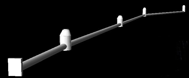

In Civil View, a pipe network is represented by an open group of related pipe and structure components. These groups are left open by default so you can select individual components within each pipe network and edited them if you so desire. However, you can opt to manually close each Imported Pipe Network group.

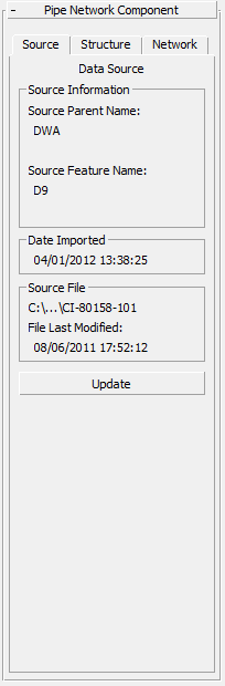

Displays source information relating to the selected pipe network structure or pipe component.
The date and time on which the parent pipe network was created from the indicated source file data.
If this date is later than the date on which the object was imported, this indicates that the selected pipe network might be out of step with your current source design data.
This value is blank if the source file cannot be found.
See Civil View Object Updating for further details.

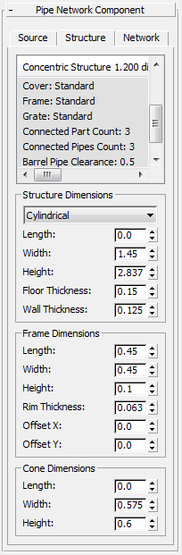

Displays when you select a structure component. Shows dimensional and attribute data associated with the selected structure component.

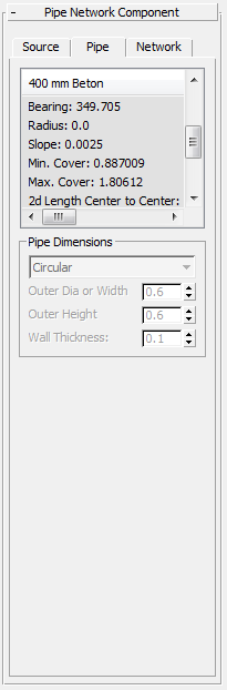

Displays when you select a pipe component. Shows dimensional and attribute data associated with the selected pipe component.

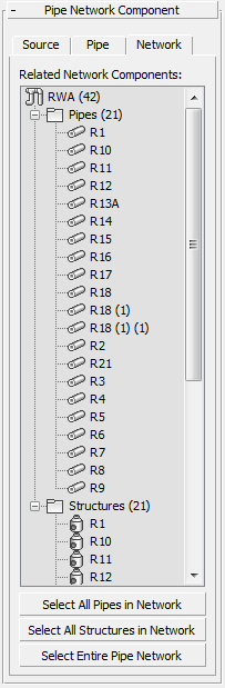

Provides an overview of related pipe and structure components that form part of the selected pipe network.
