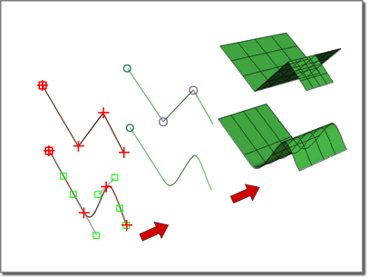

You can turn a spline into a NURBS object formed of CV curves. Once converted, you can no longer edit the spline shape parametrically, but you can edit it as a NURBS object, moving CVs and so on.
Splines become NURBS curves that then become NURBS surfaces.
